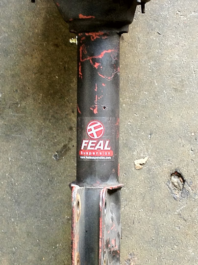

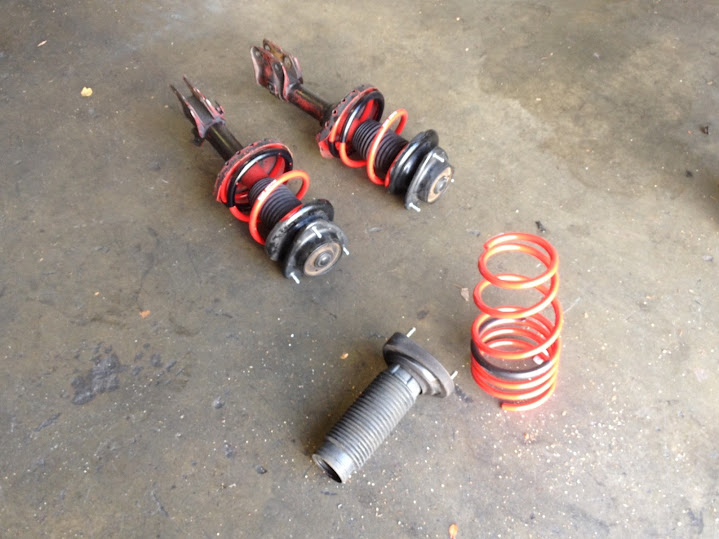

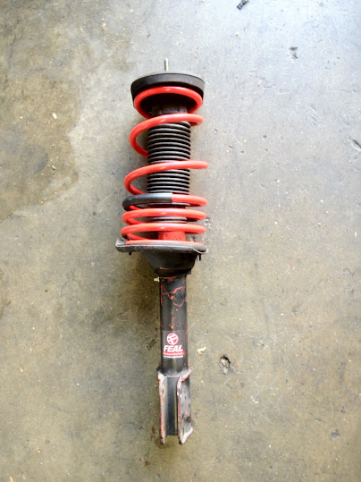

Most of you know I have been using 04 Sti strut bodies with 06 Sti inserts. The 04 inserts were badly damaged. The strut bodies were $50 bucks and the 06 inserts and 06 Sti springs were free from an AutoX friend. I have no idea why the previous owner painted over the OEM colors but I’m not building a show car here. Eventually the inserts wore out. Aurimas “Odi” Bakchis (He is Lithuanian! Not many in the states) and his brother rebuilt my suspension a few days ago. The revalve is exactly what is stated on his website http://odib.web.officelive.com/Subar...leService.aspx clean, re-grease, polish, remove nicks, remove glazed spots, fresh oil, nitrogen charge, etc. I optioned for the zerk fittings on the rear struts so I don’t have to remove them from the car to re-grease the housings. The 06 STi springs were swapped for Swift Sport linear springs for the STi.
Swift Springs
Spring rates: Front 252lbs Rear 224lbs.
Ride height: -20mm front and rear
06 STi Springs:
Spring rates: Front 237lbs Rear 195lbs.
Ride height: -10mm front and rear (from WRX OEM ride height)
